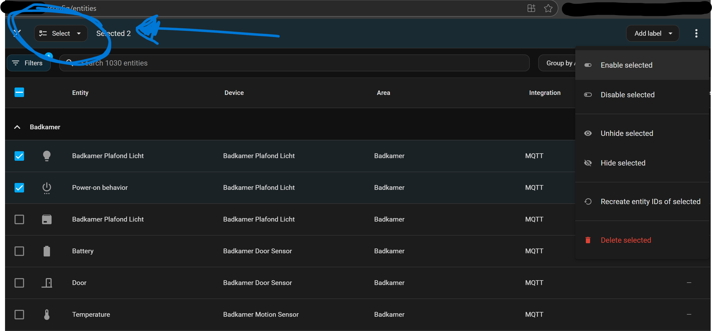

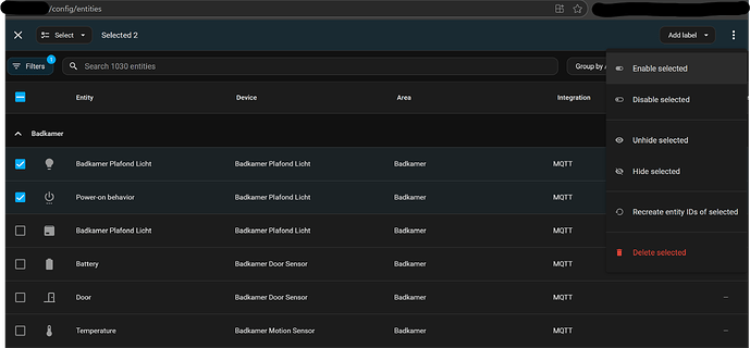

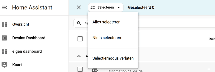

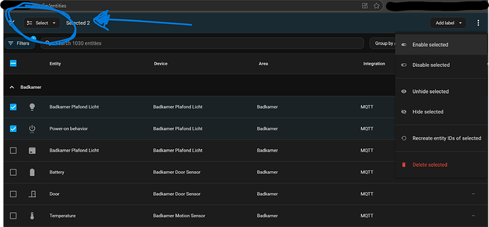

bit late to the party, but did you click the ‘select’ dropdownbutton?
The problem is not the ability to select multiple or all entities, it is the subsequent desire to expose those to the voice assistant in the same way you can enable or disable everything that’s currently selected. This is a no brainer feature if you ask me!

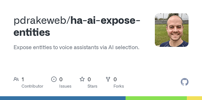

This was frustrating me so I threw together a fix this weekend. It is an AI-based entity exposer. The tool provides a dashboard which you can use to get recommendations from AI for which entities to expose and bulk-expose entities. It also adds some automation for performing those actions as well.
If you don’t have an AI subscription, just sign up for OpenRouter and use one of the free models (like Pony Alpha) or a cheap model if you’re willing to throw a few cents (literally) at it.
