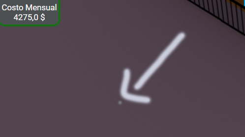

I want the button to be circle, but it is oval.
I think that can be solved with the parameter aspect_ratio: 1/1. but when I put it on the button disappears, it looks like this
How can I make it look circle?
