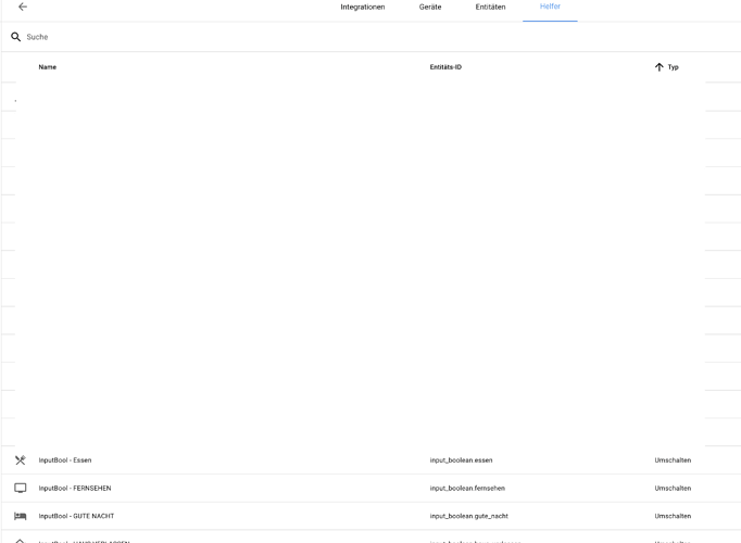

Hi Tim,
i solved now in a more less different way. Probably not nice but working for me i think there are easier ways :slightly_smiling_face:
What i did:
  1. Creating switches as helpers
  2. Creating a script do deactivate all switches
  3. Creating automation for the action of the “Button”
  4. In Dashboard creating cards which trigger an automation
To 1. Creating switches for every scene/button on "Settings - Devices & - Helpers"
To 2. Then i have written a script to deactivate all inputs
