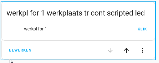

i have a button with an icon
but i want to change this icon according of the state of an other entity
this is my code , no errors but not working
type: entities
  - entity: button.x9c1t7_pressed
    icon: "{% if is_state('switch.bjx4ws_switch', 'on') %} mdi:lightbulb-on {% else %} mdi:lightbulb-off {% endif %}"
title: werkpl for 1 werkplaats tr cont scripted led

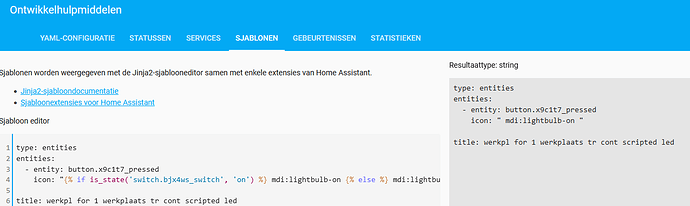

and when i test it : it seems to work as the text changes instead of the icon

Core dashboard cards (with very few exceptions) do not support templates.
There are third party alternatives and plug-ins you can use. Like
  • card-mod
  • config-template-card
  • custom-button-card
  • mushroom-card
… adding template entity row to the list from Tom in this use-case as well
