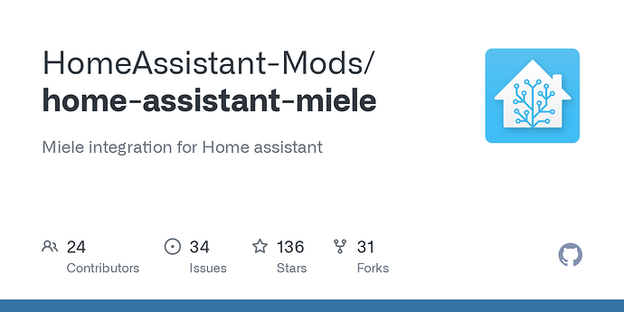

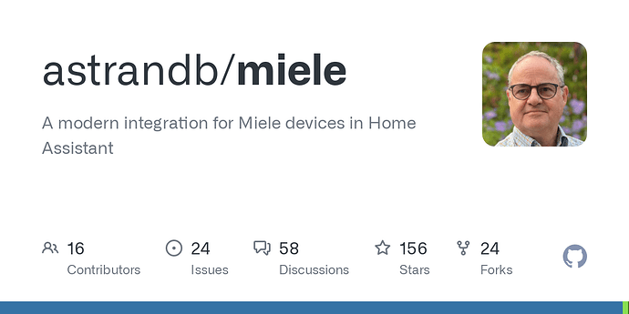

As far as I understand it, most Miele fridges and freezers can be controlled via Home Assistant. At least there are some integrations:
Couldn’t try them yet due to a lack of any connected Miele devices
There’s just a new custom integration in hacs:
