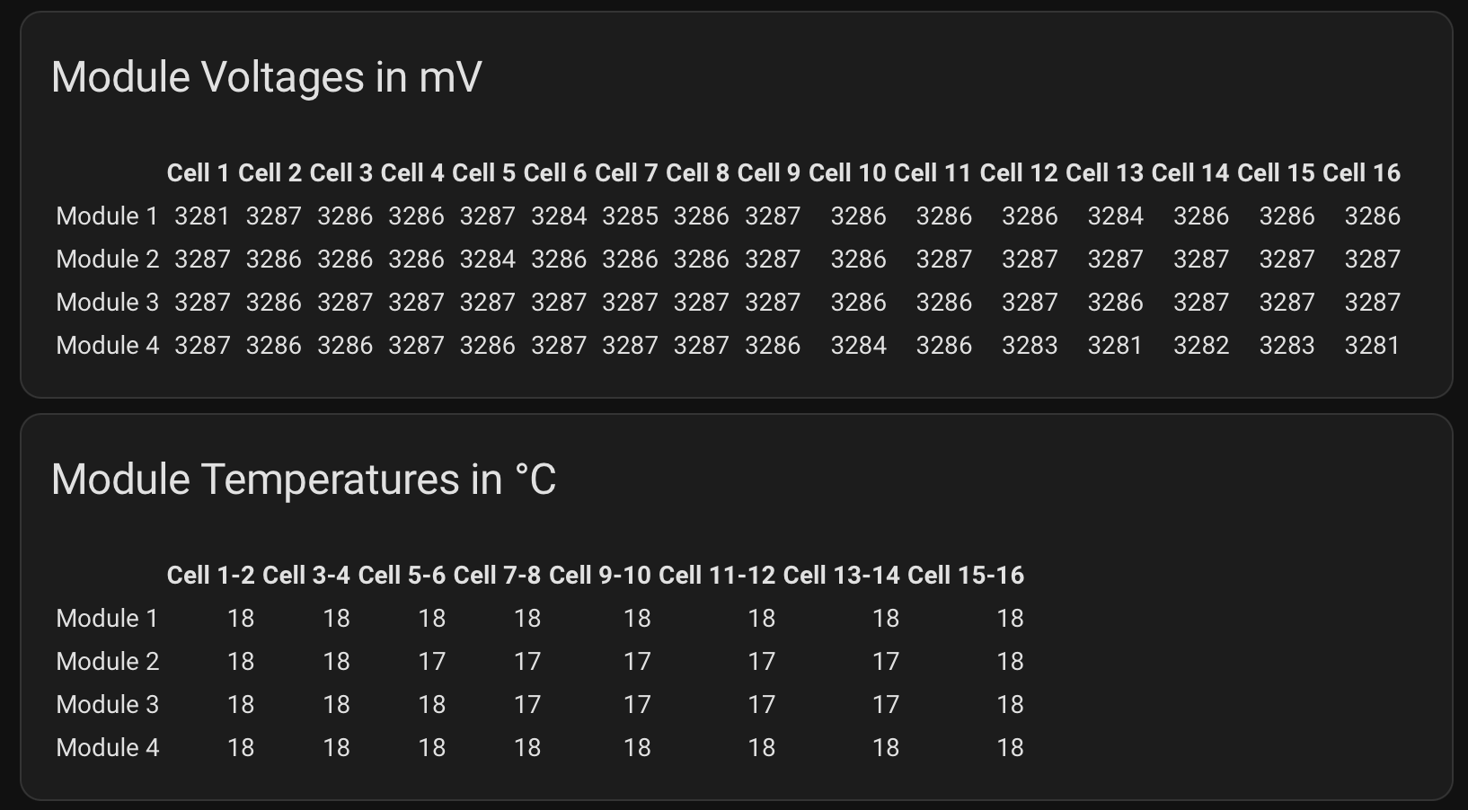

Released a new version, which adds devices for each BMS. Also cell data is returned.

  • Returning individual cell temperatures for all modules
  • Average termperature sensor with attribute with individual values of each sensor

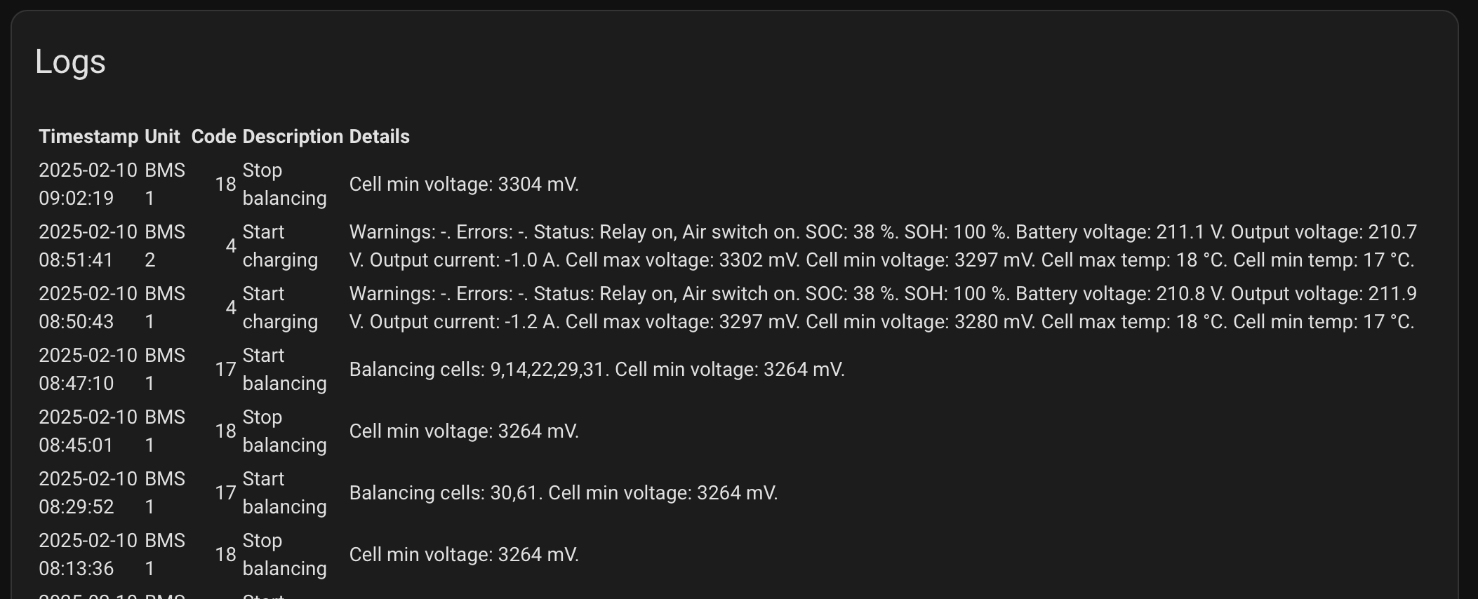

  • Added support for log data. The log data will be cached in the local folder and also written as csv file for easier further analysis.
  • Added balancing count by cell, this is based on the log entries.
  • Switched to async modbus access to reduce system load.
Fixes:
  • Fixed cell balancing indicator.
