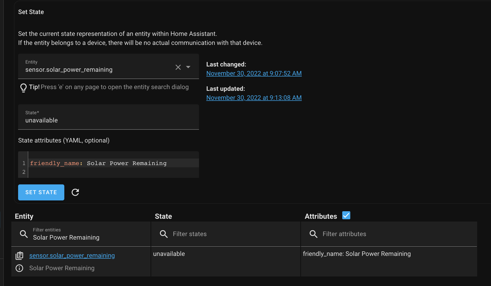

Thanks, that appears to working in the template editor but after adding to configuration.yaml and reloading templates I have a new sensor but the value is unavailable
That is logical as neither t nor ns or nr are in that sensor…you would have to add them too of course
