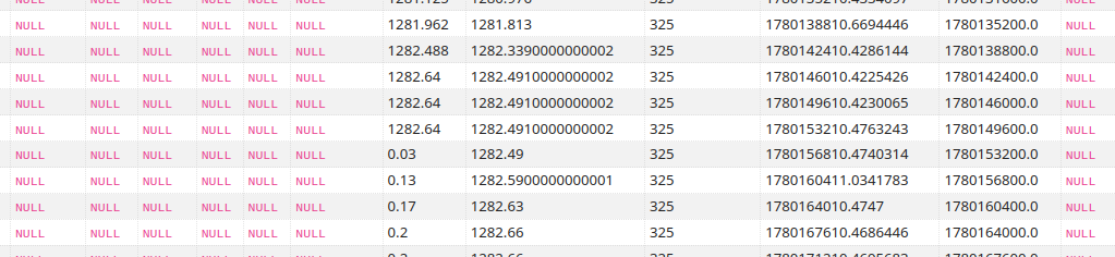

yes. I shouldn't need to sum it up manually. For my need as it's a TOTAL_INCREASING sensor, I just need to get the newest value from the sum field from long-term statistics (picture from the SQLite database):
I just need to figure out how to do this in a template.
