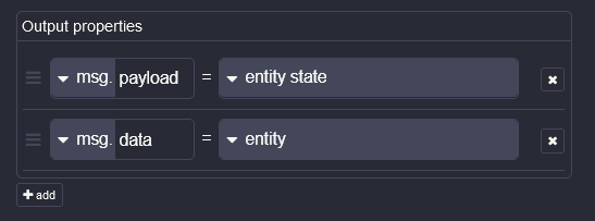

On the bottom of most HA nodes there is an output option. Here you can tell it what information to send when the node is triggered.
It can be the properties of the defined entity or any other entity or a combination of both. The above gives you the state (on/off/number, etc) of the defined entity to msg.payload. The entity, state and all attributes are sent to msg.data.
