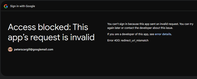

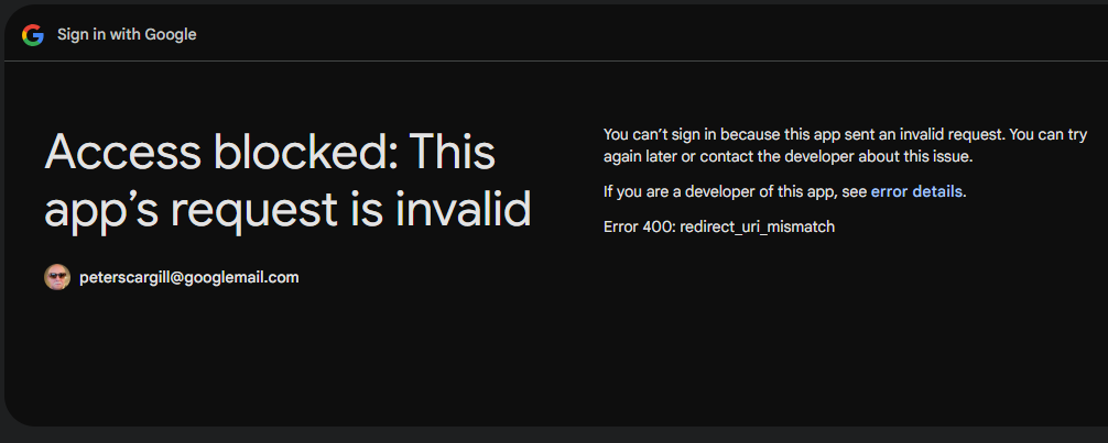

Oh, I want to use the Google Calendat - it just won’t let me. Possibly as I use 5G for broadband, no proper public address?

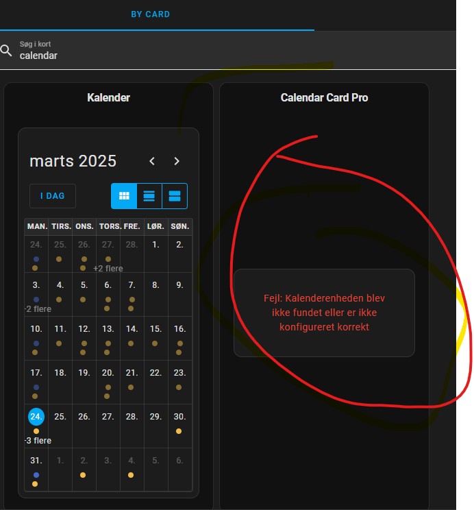

I am doing something wrong.
Installed via HACS, reloaded site and restarted HA.
When trying to add the calendar to a dashboard i get this error.
Check image
What happens when you just tap the card and add it to your dashboard? You should just be able to configure it, the auto detection for entity is not really needed for anything.
