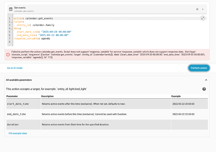

I am getting this issue and have tried doing everything in these posts to get the response_variable information but constantly get this message
