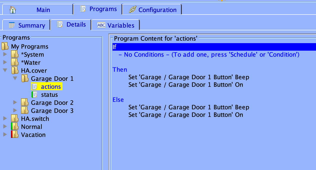

I’m curious if garage door support (through an IOLinc) is working through Home Assistant yet. When I connect up my ISY, it sees the sensor and relay separate, but there seems to be no way I can see to specify these things as a single garage door in Home Assistant like there is in Homebridge.
I doubt there will ever be a Garage Door Cover component for HA ISY994 for the simple reason there is no garage door Insteon device. It you look at the bottom of the ISY994 Control page you will see a “Creating Custom Devices” section which uses programs to create unique components one of which is HA.cover. This approach will give you exactly what you need.
Here is what my garage door HA.cover looks like and it works perfectly. With my setup I get the following covers…cover.garage_door_1, cover.garage_door_2, and cover.garage_door_3. My garage door have the typical single switch to open, stop and close so my actions script is the same for both then and else paths.
This seems like a really round-about way (more complex than it is in Homebridge) to make your garage door work. Are there plans to improve this?
The ISY-994 does not support the concept of a “Cover”. The ISY994 Home Assistant Controller component allows you to emulate a cover using the approach I described above. Once this cover is available in Home Assistant you can use Homebridge to control it. This is the only way you are going to get what you want.
