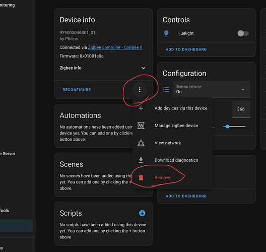

On the device screen, you can open the menu in the first box and select “Remove”:
I’ve used this several times and never had this behavior you are describing.
