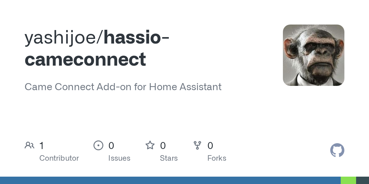

I’ve built a small Home Assistant add-on that works as a local REST proxy for Came Connect.
It handles login to the Came Connect cloud, token refresh, and exposes your gate with simple REST endpoints inside your HA network.
With it you can:
  • Check normalized gate status (open, closed, opening, closing, stopped, unknown)
  • Execute commands like Open, Close, Stop, Partial opening, Sequential, etc.
  • Inspect and debug your authentication token
