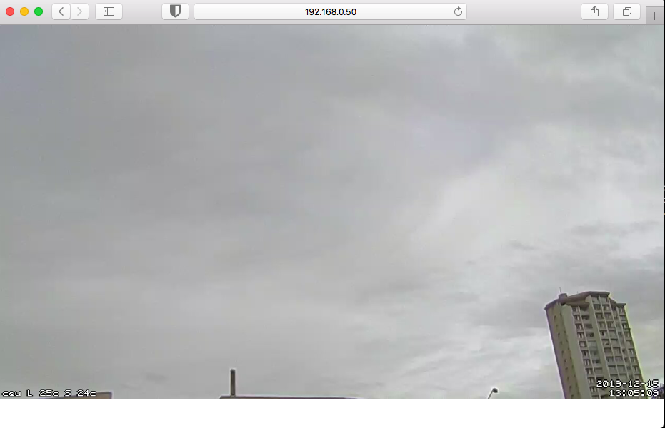

Well… I just started a new appdaemon-dev container with minimal configuration and a single dashboard with a camera widget. Here is what it look like:
if you move the mouse to the image you can see the it will open the HA camera URL, not a dashboard URL. And if you click you ended in the camera image:
No back button or click image to go back. Dashboard configuration is as simple as:

i think that must be an option from your camera itself or from HA.
and the url makes me believe its something in HA doing that.
allthough its also possible that its a feature from the program you use to display that dashboard.
its definitely not something that comes from dashboard

i dont use docker, but i know the code from the widget. there is just NOTHING in the widget that would do that.
i know its on the wishlist from a lot of people, and i know there are custom camera widgets that do that.
but its not in the code.
but i dont have my cams inside HA anymore and my HA is not up to date.
its a HA link that is used to view the cam, so its very wel possible that a recent HA change caused that you think its an AD change.
but you can easy check that.
view the cam directly in a browser (without dashboard) or even better view it in an iframe.
you can even view it in an iframe widget from dashboard, and i think you will see the same behaviour.
