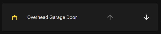

So… after burning the image to an SD card and starting up my PI3, I installed a File editor, FTP, Node-RED, and Mosquitto broker (for later). I added in integrations for AccuWeather, the Mobile App, MQTT, ring, and of course SmartThings. Then I added in the myQ integration because, lo and behold, HA actually supports it and it doesn’t require the subscription that IFTTT does. HA recognized the myQ unit and I was good-to-go on door control.
