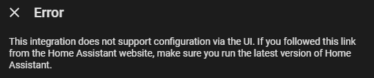

The link at
Add to Home Assistant
gets me this:
My instance URL is correct, I used it dozens of times before.
The route via
  1. Open HACS → Integrations → ⋮ → Custom repositories
  2. Add evandcoleman/campass with category Integration
  3. Install CamPass and restart Home Assistant
seems to be working fine, though.
