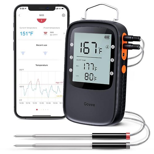

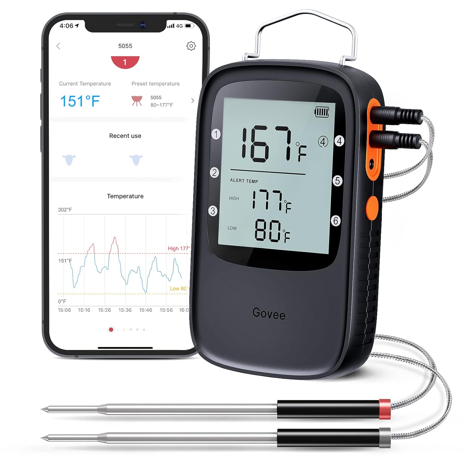

This is a bit of ‘hillbilly’ tech :wink: however you might have a look at this BLE device, as it ‘meats’ :wink: your no soldering requirement. Would require a ESP32 device (maybe not need the esp32, as the ‘theengs gateway’ might be able run on your Home Assistant server if it has a available and accessible BLE adapter, however I like keeping my HA server as simple as possible so the ESP32 route) to translate the BLE to MQTT or HA API’s but that gives you range extension options as well. And this device has local display, multiple inputs and fairly low cost. Good hunting!

David, thanks a lot. While the Gove B5055 or H5055 does not seem to be available in Europe, I will expand my search to meat thermometers, I didn’t think of these before. What I’m a bit unsure is if they will be able to properly measure the range of 50-70°C (120-160°F). And also, if I find another meat thermometer with Bluetooth, if it is compatible with HA via a bluetooth proxy on a ESP32 or only with a proprietary app.

Bummer on the Govee availability, I’ve had very good experience with several of their thermometer devices, especially those which use AA or AAA batteries, very long time between battery changes, good temperature and humidity range/accuracy and very good BLE reception distance. And good temperature ranges. Here are the specs for their meat thermometer, 0 to 300 degrees celsius. As was noted by another poster, Inkbird has some devices available in EU, with similar specs and price points, however I cannot speak for the decoding in Home Assistant. The one linked below looks similar to the Govee unit, 2 input, AAA battery, relative low cost and Home Assistant compatible according to the HA web site. Good hunting!

Nice find. Unfortunately I just realised that the probes of a meat thermometer are too long (and not flexible), so I cannot place them in direct contact with the copper pipes (see the red arrows):

Yes, even my hacked up setup where I am using the probes in my Air Fryer, they are a bit too long. In ‘theory’ these are standard thermocouples, however beyond my pay grade to figure out of what type they are and how to replace. Think they are thermocouples and not something like a more standard temperature probe such as the DS1820 type probes as they can handle 300 degrees vs 125 degrees.
