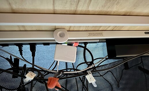

I ended up going with a SmartThings Aeotec ZigBee motion sensor that I had lying around. Conveniently, that model of motion sensor has a built-in magnet at the back of it, and my standing desk also happens to have a couple of steel beams that run the length of the desk.
So I stuck the motion sensor to the one of the desk’s steel beams (facing my desk chair), and I intentionally chose one of the steel beams that was toward the back of the desk on purpose so that one of the desk’s other beams would block a portion of the motion sensor’s view (so as to try to limit the motion sensor’s view of anything other than my legs and feet as I approached the desk):
(What you see above is the view of the motion sensor if you were to be looking straight at the desk from the height of my desk chair’s seat.)
And here’s what the motion sensor’s positioning looks like if you were to look up at the bottom of the desk from the floor:
All in all, this setup has been working pretty flawlessly, and I couldn’t be happier with it. One aspect that I’m particularly happy with is that because I’m using a motion sensor rather than a vibration sensor, I don’t even have to touch my desk chair; rather, my screensaver automatically turns off when I’m about a meter from my desk.
