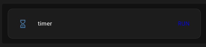

              I recently came across the timer-bar-card frontend (GitHub - rianadon/timer-bar-card: A progress bar display for Home Assistant timers) and have been gleefully finding places to insert it in my existing cards.
I have a script that runs an air filter for 10 minutes.  The top is the original script entity card, the bottom is how the timer-bar-card entity looks.
If I activate it, it then looks like this:
Is there a way to alter the “Off” in the timer-bar-card to “RUN,” so it looks like the standard script entity?
              Like this…

              Found a way.
Looking at some examples in the timer-bar-card, I realized I can punch in a translations line.
    type: custom:timer-bar-card
    duration:
      fixed: "00:10:00"
    tap_action:
      action: toggle
    hold_action:
      action: call-service
      service: switch.toggle
        entity_id: switch.air_filter_socket_1
    sync_issues: fix
    state_color: true
    translations:
      off: RUN
So “off” becomes RUN.  Interestingly “off” is acceptable but “Off” is not.  Now to find out how to color it.

              You can adjust the colors with card_mod if the timer-bar-card is embedded in an entities card
type: entities
entities:
  - type: custom:timer-bar-card
    sync_issues: fix
    state_color: true
    entity: timer.timer
    translations:
      idle: RUN
    card_mod:
      style:
        timer-bar-entity-row:
            div.generic-entity-row: |
              div.text-content.value.pointer {
                color: blue !important;
                padding-right:10px
