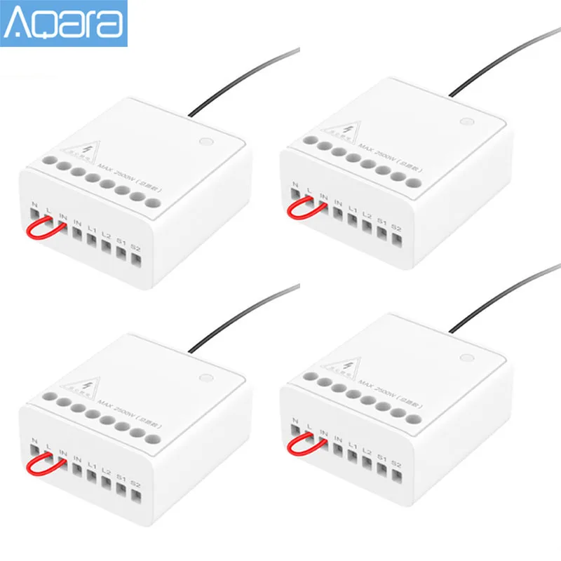

I have just ordered on of these Zigbee 2 way controllers to try out.
