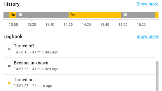

Does anyone know why I am getting a short interval of state unknown between on and off using this:
command_line:
  - binary_sensor:
      name: Virgin TV 360
      command: 'nc -z 192.168.0.x 8081 > /dev/null 2>&1 && echo ON || echo OFF'
      icon: mdi:set-top-box
      scan_interval: 30
It happens every time.
You need to set the “command_timeout” higher (default is 15 seconds). I set mine to 300 seconds, now it works perfectly without the “unknown” state.
