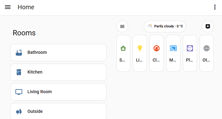

Here’s a more complete working demo.
dynamic_view_working
My auto-entities card with the different areas:
type: custom:auto-entities
card:
  type: custom:layout-card
  layout_type: custom:horizontal-layout
  layout:
    width: 232
    max_cols: 2
    margin: 0px -4px 0px -4px
    padding: 0px
filter:
  template: |-
    {% for area in areas() if floor_id(area | replace("_", "")) != "virtual" -%}
          "type": "area",
          "area": area,
          "display_type": "compact",
          "tap_action": {
            "action": "navigate",
            "navigation_path": "/lovelace/area#"+area,
    {%- endfor %}
The dynamic view
type: custom:config-template-card
entities:
  - sensor.heartbeat
card:
  type: markdown
  content: ${window.location.hash.slice(1)}
Now because navigate is not a full webpage refresh, I had to find a different way to trigger the update, otherwise the value wouldn’t change. I created a ticker that updates its state every second like so
template:
  - triggers:
      - trigger: time_pattern
        seconds: "/1"
    sensor:
      - name: "Heartbeat"
        unique_id: heartbeat
        state: "{{ 0 if is_state('sensor.heartbeat', '1') else 1 }}"
        icon: "mdi:heart-pulse"
The only thing I wish I could do is somehow cache the areas, as they don’t tend to change that often.
