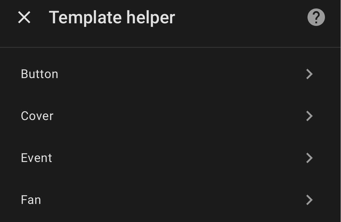

Or create a template helper from gui

Right now I have created 7 template buttons (one for each speed, one to turn the fan off, and one to toggle the light). This mimics the buttons on the remote.
It works but I don’t like that I have to create/manage/maintain 6 template buttons that aren’t related/grouped.
I thought I could use the template fan entity but it requires a way to get the state of the fan and that won’t work since I have no way to know the current state of the fan. Someone could do something with the physical remote and HA wouldn’t know.

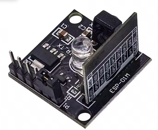

You could set up a IR receiver to read whatever is sent from the physical remote.
That still isn’t reliable, commands can easily be missed.
Yeah. :confused:
Ha. That is a good idea. But no, my wife still likes the physical remote. Now maybe I can replace it with a smart remote.
I was looking for such a thing. Is there one? Do you have a link?
https://www.aliexpress.com/item/1005005777409596.html
