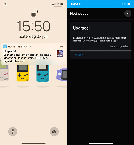

This is what it looks like
From left to right. iOS notification & Home Assistant Notification area

- id: '1552424898989'
alias: system_upgrade_alert
trigger:
platform: state
entity_id: sensor.release
condition:
- condition: template
value_template: "{{\n states('sensor.release')\n !=\n states('sensor.current_version')\n\
action:
- service: notify.mobile_app_iphone_YOUR ENTITY
data_template:
title: Upgrade!
message: Er staat een Home Assistant upgrade klaar voor Hass.io! Versie {{ states('sensor.release')
}} is zojuist released!
content-type: png
url: https://EXTERNAL-ADRESS:8123/local/images/upgrade.png
- service: persistent_notification.create
data_template:
title: Upgrade!
notification_id: hassio_upgrade

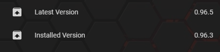

Here’s my config:
- platform: version
source: local
- platform: version
beta: false
image: raspberrypi3
source: pypi
It produces these sensors:
