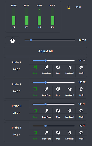

I have created these binary_sensors to determine which probes are connected. I use these in conditional cards to only display the probes that are in use.
They need an entity (in this case named number.probes_connected) which returns the value from ID 111.
I have this in my binary_sensors.yaml
Thought I’d share.
