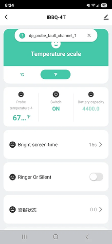

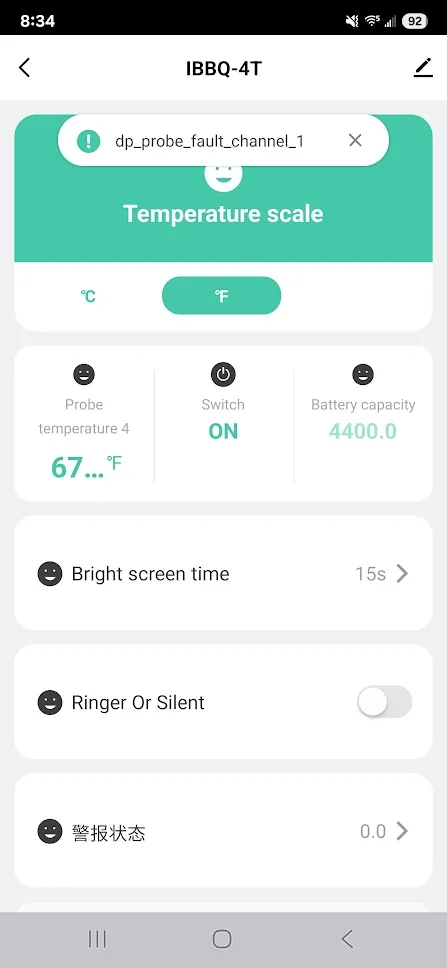

Ok trying to get this IBBQ-4T to work and is there a trick to actually add it to Tuya itself? I get a few errors when trying to add it via. the Tuya smart app and I also am unable to change the language definition:

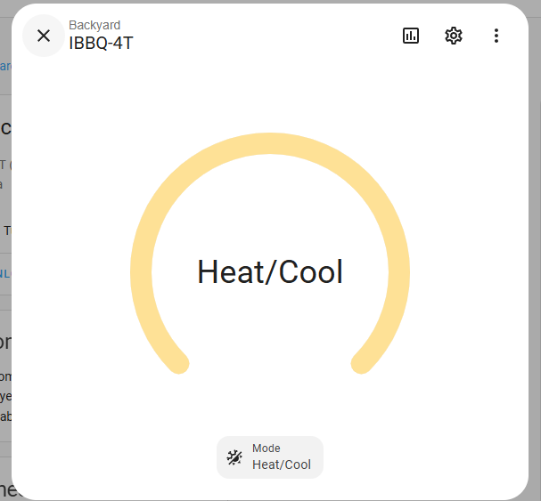

So Tuya sees the Inkbird as it should, it’s when I link Tuya to Hassio that Hassio sees it as a thermostat rather than a BBQ meter.

I’ve bought last week an IBBQ-4T to work this together with HA. At this moment I’ve got a Heat icon and can switch on or off this meter. Do I understand correctly that’s it not possible anymore to get the temperatures in HA by local Tuya ?
