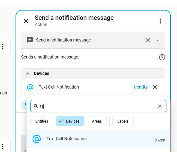

i figured it out in the end.. was getting frustrated how it works 1 min and totally broken later.
so its Not and Entity and its not a Service
its actually a Device so you gotta change from entity to Device to fix it in the end.. i didnt see it as i wasnt editing through the UI and when i did i saw entitie devices areas labels
it will also say 1 entity
but thats how i figured it out in the end its a Device now where in the past it was a entity when i had setup the automation a few years ago.
also seems the party thats being depreciated is the action
called
Perform action 'Send a notification with text_cell_notification'
so you need to set it to
send a notification
and then you gotta choose “Device” so the example they gave where it says your format is being depreciated in 2027 is wrong

well thats wrong you cant do it in the yaml you gotta do it in the gui..
and the yaml looks like this
          - action: notify.send_message
              device_id: 02520ac22eb70eb433f829e44d8d8069

was frustrating trying to figure it out when i followed there exampl they told me how to do the new format.. yet its not really notify. as an entity.. but a device and you gotta use there device code

here is how i found it

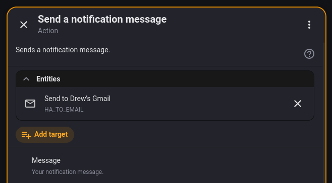

No, you don’t.
If you want to, you can use the Device as a target… for that matter, you can also target Areas or Labels if your notify entities or device have been assigned those.
But you, absolutely, can use the notify entities from SMTP (aka the Recipients) as targets:
  entity_id: notify.email_drew_gmail
  message: test
One important difference is that using a Device target will send the message to all the Recipients for that integration service instance. If you want to choose specific Recipients, you have to target the Entities.
