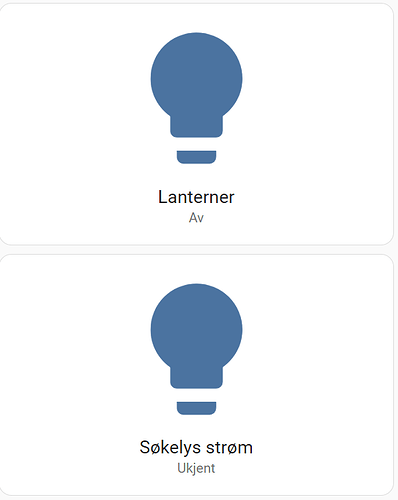

Here you can see that the lanterns are off (av), but the searchlight is unknown (ukjent).
That means that I am unable to turn on the searchlight until I have been into a totally different view, where there is a regular card with much smaller buttons, and turned it on or off with the lightning symbol:
