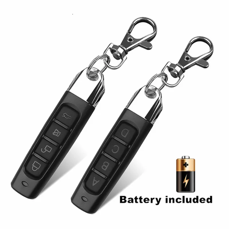

I have a few 433mhz remotes that work with my HA. They’re cloning ones, like this.
Now the 2 different styles have different codes, but in total I only have 8 “pre-programmed” codes to work with. I was looking for a way to program/change the codes. Since I have several remotes and having them all unique would be more flexible for automations and such.
Not sure what you are asking for. If you have 8 "buttons"you will have 8 codes. If you use RFlink or other integrations you will be able to read those codes and use them. The codes should normally all be unique.
In HA though you could create more RF codes that you could use to link devices to and still use the 8 codes for essential tasks you like.
I have KAKU devices and they are not programmable but I created my own codes to control switches via HA.
Did you tried to open them so as to see if there is some dip switch to change the code ?
It could be also some jumpers or contacts to solder.
I’m wondering this same thing. I just bought a few of them and I have a ton of 433MHz devices all around my house with unique codes – the two remotes I bought are both 4-button but different styles.
As it turned out, my 433MHz snooper showed that they both had the same pre-programmed values!! They are also programmable the same way for cloning a source remote.
However, like the OP I want to build a way to program my own unique 433MHz code into them so I can associate it with my Sonoff RF bridge and do cool things in my smart home.
I’m thinking about building an ESPHome 433MHz broadcast device I can program with my own code(s) so I can use it as the “source remote” for cloning operations. A long time ago I ordered some of these RF transmitter STX882 & receiver SRX882. I played around with them a little but this might be a really good use of it!
Just wondering if anyone has tried that before. :slight_smile:
