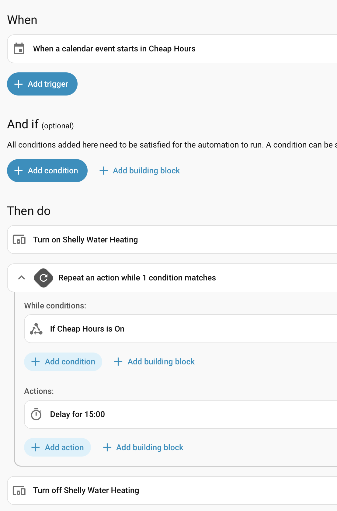

Situation is now simplified to see, if the while loop is working. In the loop there will be more actions and condition. So the problem remains, why while loop is not triggering?

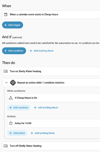

Well there is the code:
alias: WaterheatingLowNightUsedValue
description: ""
triggers:
  - trigger: calendar
    entity_id: calendar.cheap_hours
    event: start
    offset: "0:0:0"
conditions: []
actions:
  - type: turn_on
    device_id: af7121eceb8dde0303ddf54eb6fbfc8e
    entity_id: 0e342bc67057f0f029c413adb9ef5921
    domain: switch
  - repeat:
      while:
        - condition: state
          state: "on"
      sequence:
        - delay:
            hours: 0
            minutes: 15
            seconds: 0
            milliseconds: 0
  - type: turn_off
    domain: switch
mode: single
Reoelvant part is this:
 - repeat:
      while:
        - condition: state
          state: "on"
I know that event exists, but while does not trigger. From logs I can see, that wait is newer run.
