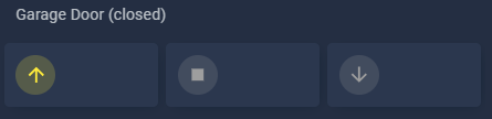

But putting this cover on my dashboard, I see f.e. this :
Schermafbeelding 2022-09-06 144951
Where can I mention when a button may be enabled or not ? In my case the stop button may only be enabled when the garagedoor is moving. I also want the arrows up and down both enabled, except when the door is completely open of closed (I would use a door sensor for this).

no, back to bases : just created 3 buttons on my dashboard, so I could activate (yellow) / deactivate (grey) these as I want.
