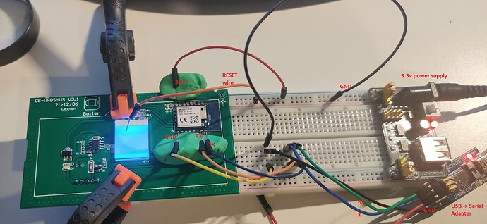

If tuya convert also doesn’t work, then serial method is your only option.
Fyi, you can avoid soldering by using dupont cables and blue tacs
