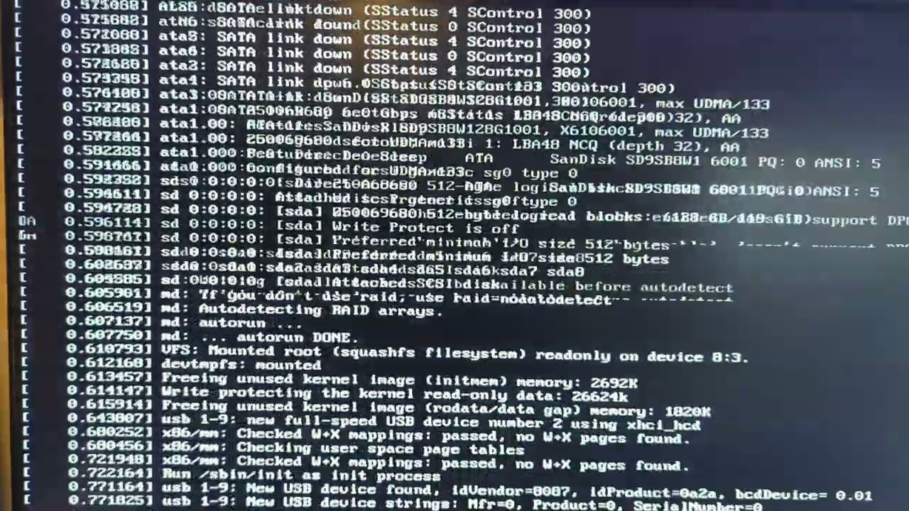

Here is video of bootup when I connect it to monitor. Oddly, I can go to the Observer address and I get Connected, Supported, and Healthy. But try to go to 8123 and no go, and as I said, no zwave/zigbee devices work.

What does info show you on the console? Is HA showing as frozen or running? From your original post you say that the ping succeeds, but the GUI fails, which implies that HA is not fully started. The fact that your Z-Wave and Zigbee also doesn’t work all points to HA being hung up.

I agree, it appears HA is not fully starting. Starting enough to get network, but not enough to really fire up anything else.
