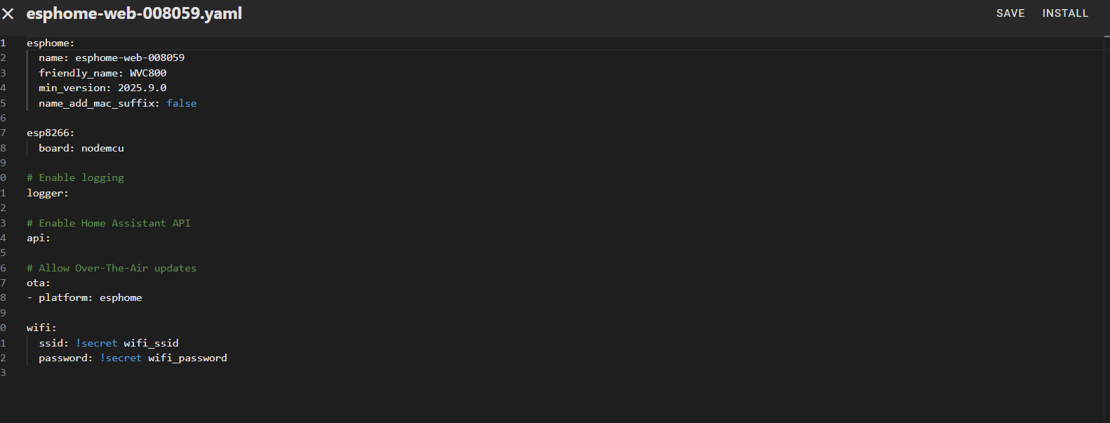

i´ve got a lot of trouble configuring my esp8266 in esphome builder… not even the standard flashing procedure is succesful… tried some thing but they didn´t work out…

in my understanding i just have to edit the yaml file this guy wrote to my esp but this is the problem i have. ereverytime i fix one error tghere is the next… gonna upload some pictures here…

i´m edititng the yaml file of my esp found in my builder… then click on install…

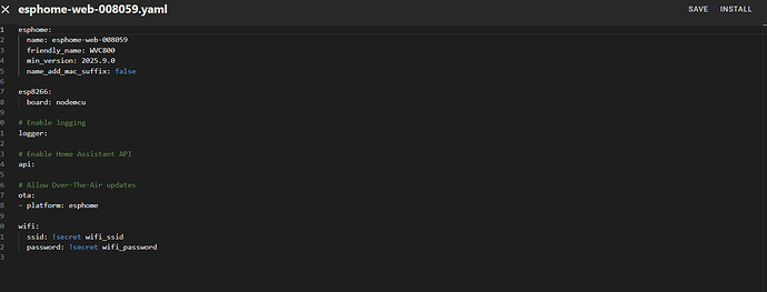

at the moment i´m still having prblems with the basic configuration as you see. the esp is only prepared with webflasher… the standard installl even fails after that as u can see in picture above… thats nothing edited…
this fails :frowning:
i bought other esp8266 for that my old ones were cp2102 wich was even more trouble… new ones are ch340 working better…
If you are running Esphome builder as an addon on the RPI 3b+ you are very unlikely to have much success. It’s a bit short on RAM. It would be better to run it on the Win11 machine.
