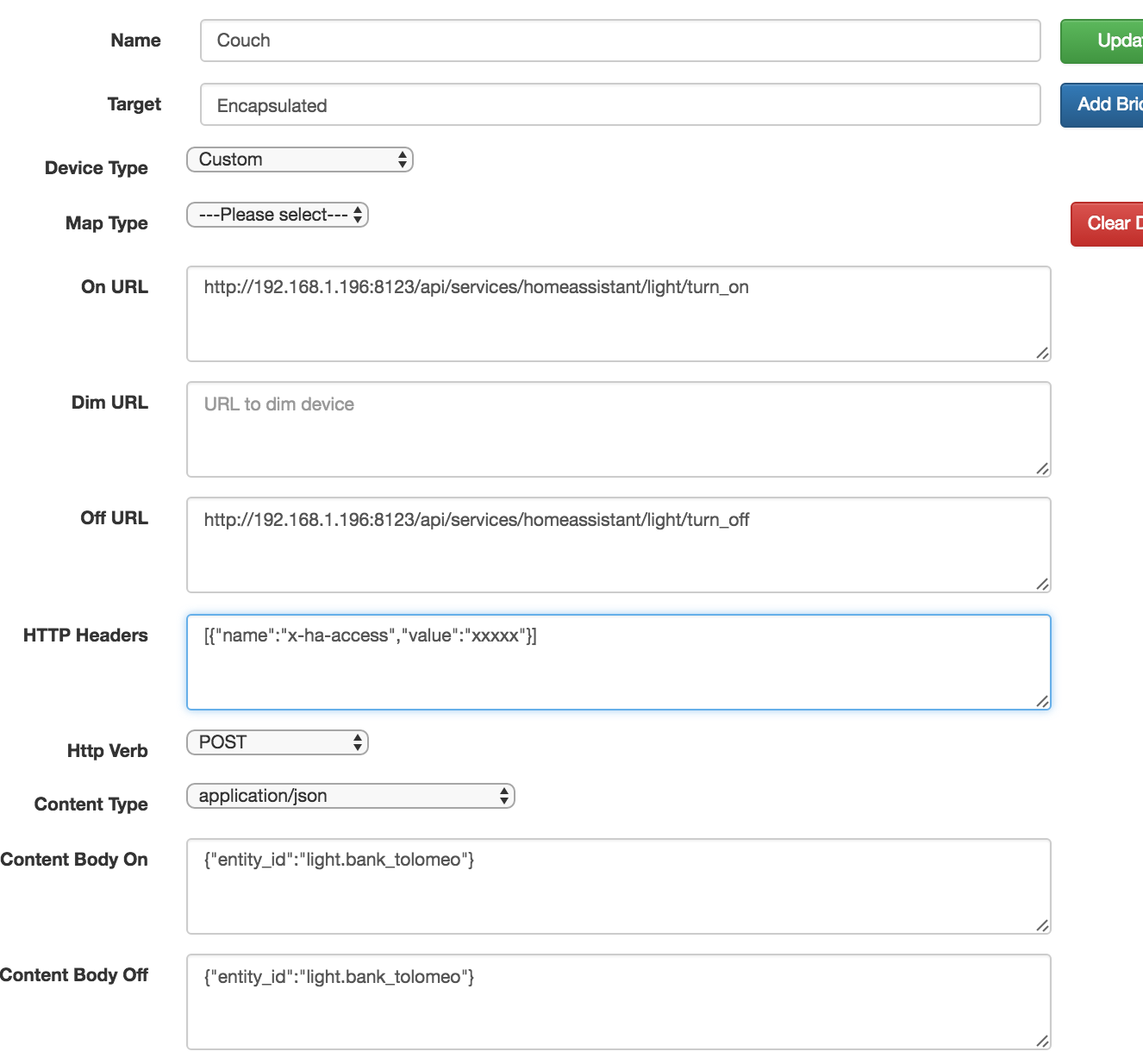

Struggling to get the HA bridge to post commands to HASS. I know HA bridge is working as I also have a Vera setup in HA Bridge and that is working fine.
Interested in seeing some examples e.g. with dimable lights. I also read about an example where a thermostat was controlled via HA bridge (faking it was a light).
Below a non working example and really struggling what is wrong with it…(xxxx is of course Hass PW)
Ok , my bad. Wrong URL. Below is correct.
However still would love to see some examples. The light in this example is a dimmer and would love to see how it would work with a dimming value or thermostat.
