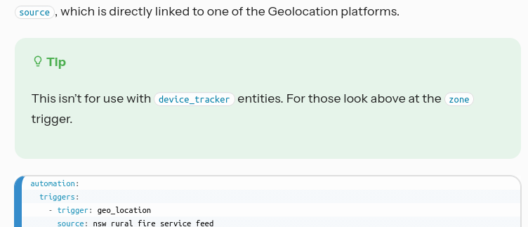

That’s not how the Geolocation trigger works and that’s not how one is properly configured… you cannot leave source blank. The Geolocation trigger is a specialized trigger that works with a small set of services, it is not related to device_tracker or person entities.
As the docs state, you want a Zone trigger.

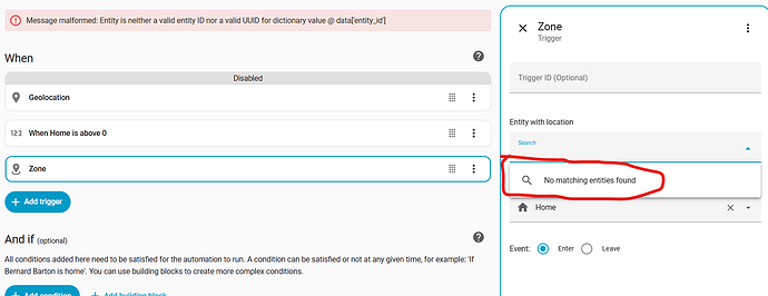

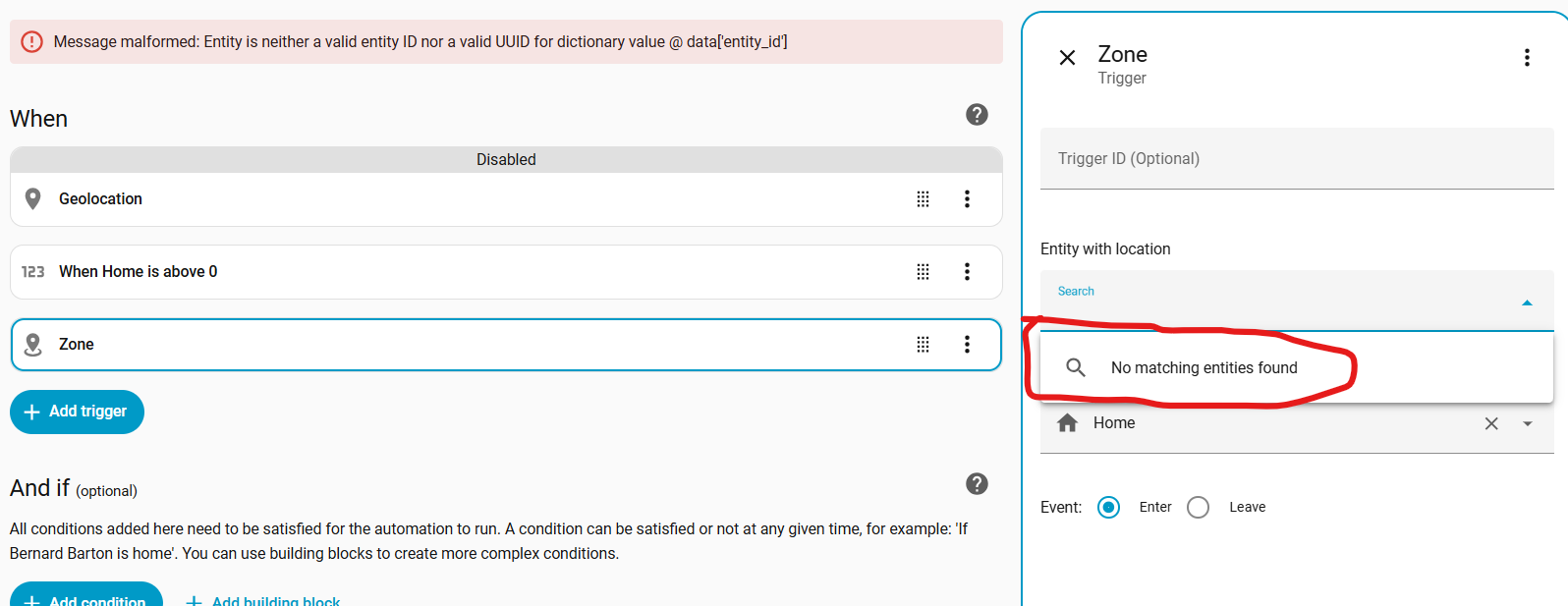

Thanks. Part of the zone trigger docs say to configure GPSLogger which I did. But I noticed the URL I optained from the integration for use on the phone is a local network address http://10.99.1… I don’t understand how this would work if you are some distance away from your local network.
Also when I try to add a zone trigger I get the following error. No matching entities. Any help would be appreciated.
The docs say you need to have a device tracker platform that supports reporting GPS coordinates. It doesn’t have to be GPSLogger. Most users use the HA Companion app since it adds a lot of functionality including location tracking.
All GPS-based device location tracking is going to require that you set up remote access of some kind. I have no experience with that particular integration, and based on the analytics it is not widely used so you may have trouble finding up-to-date information about it.
Zone triggers require either a person entity or a device_tracker entity. If you setup GPSLogger it should have created a device_tracker entity. If it did not, then you need to check the integration.

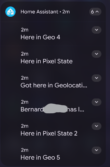

The I took my phone for a little ride, returned home, and nothing. At least at first. Then suddenly after several minutes being at home, I received notification from 5 of my test presence apps:
Here are a few of them. I thought that Geo 4 using the zone trigger would certainly work.

The reason for the delay could be the update frequency of your position, or that you did not set the importance flag/ high priority on the message.
Without it, the message will be delivered when the phone wakes up, with the flags it will wake the phone up
Introduction | Home Assistant Companion Docs
So this worked. That’s good!
Previously it wouldn’t work most likely is because when your phone / companion app is outside of your home network, the app did not have a way to connect back and tell your HA server that the GPS info is changing / that you are actually out…
That did it! I set the message priority to High and received it before entering my house.
