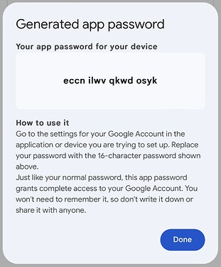

I created my app password (note: this isn’t the password I’m using, only created for this screenshot):

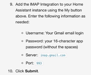

Then I followed the steps to set up the integration
In the setup dialog, I typed my email address (e.g. [email protected], deleted in the screen shot below), into the Username field, entered the password I received in the dialog above, without spaces, into the Password field, but I comes up as “invalid authentication” every time.
