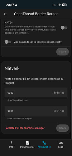

I have test different port as 9080&9081
Help, what is the problem

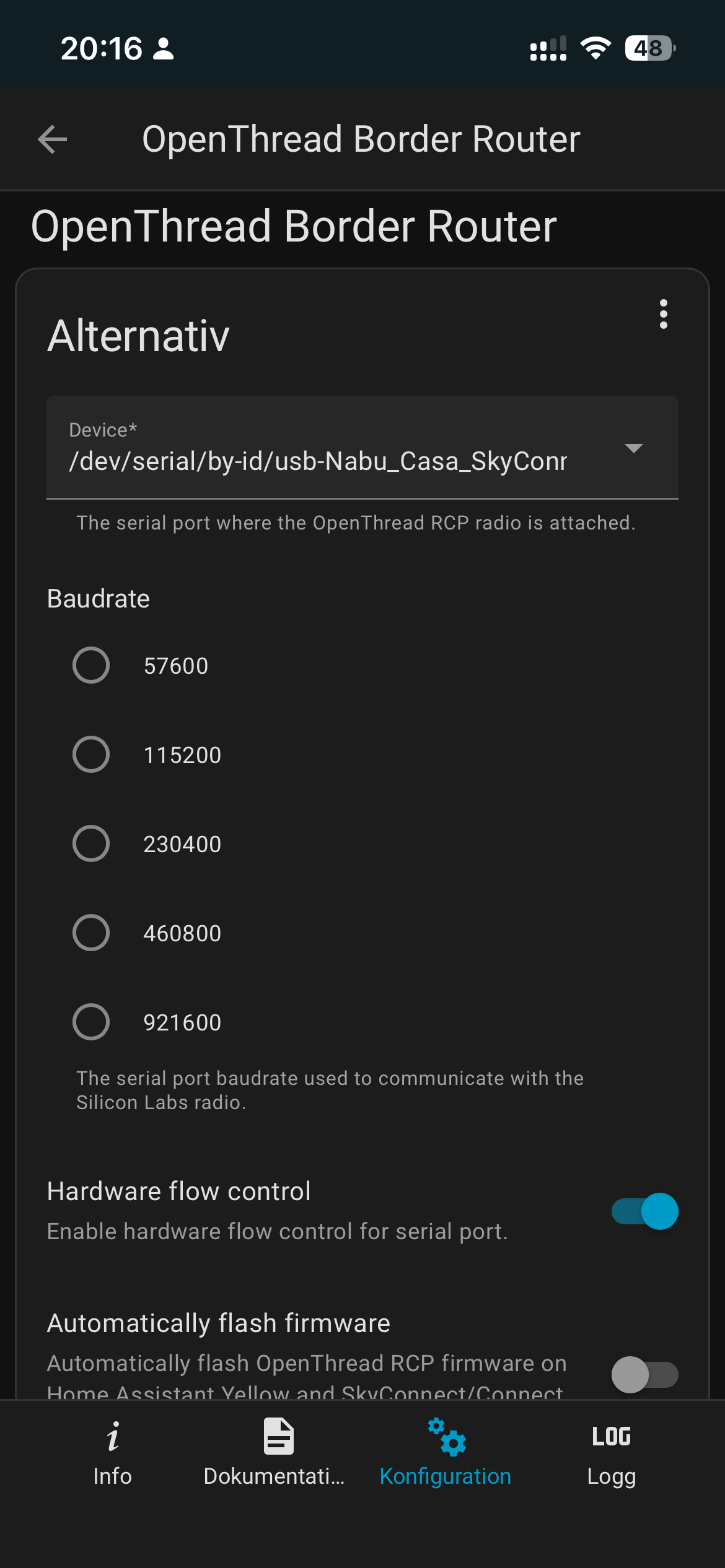

Maybe show the configuration, above seems the cause.
I have test to stop addon deconz
Then is possible to start OpenThread Border Router✅
But i have change port, or is not possibel to change port on OpenThread Border Router
I’m kinda working from memory, but I think the port config is used only to enable the OTBR’s Webserver port 8080, not so much to change the port number. Anyway according to the WARNING
it is using 8081 anyway, so I guess changing the port number is not actually supported.
Yes. I guess that is the problem.
I docker is possibel to set the port with env
OTBR_REST_PORT: 8081
OTBR_WEB_PORT: 8080
But not sure how to do that in addon.
Or is not possibel to. run deconz & openthread parallel??

It looks like the issue is that the AddOn run script always starts otbr-agent without exposing the --rest-listen-port parameter.
scrtip…
The otbr-agent binary does support --rest-listen-port to configure which port the REST API should listen on, but the AddOn currently hardcodes port 8081 and doesn’t allow this to be changed.
Because of that, anyone who needs to run the REST API on a different port is blocked. This also explains the error we see, since the agent only binds to 8081 by default.
Suggestion:
If the AddOn exposed --rest-listen-port as a configurable option in the run script, users could override the port when needed
