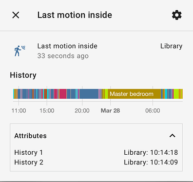

logging my motion sensors in a couple of small AD scripts, I was wondering if we can make history of these sensors survive a HA restart.
Previously I did the same with a CC Variable, where we could set restore: true. Wondering if this can be done in AD too?
to be more precise: the current sensors state Is restored/recorded, I am talking about the attributes list History X

If you want the sensor to persist reboots, it would be best to store it within a persistent AD namespace. The problem is that the sensor will not be within the HA namespace and cannot be displayed within the HA GUI. You can copy the sensor data from the AD namespace to the HA namespace and have it in both places as well.
