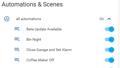

You can use Thomas Lovens fold-entity-row like this:
          - type: entities
            title: Automations & Scenes
            show_header_toggle: false
            entities:
              - type: custom:fold-entity-row
                open: true
                head: group.all_automations
@wmaker, thanks for the info, it seems to be the last I needed in order to get this going. I’ve got the monster card all setup now and it’s working great!
@DavidFW1960, I’ll definitely have to check that out, as I like the idea of being able to collapse the entries. Thanks for the tip!
