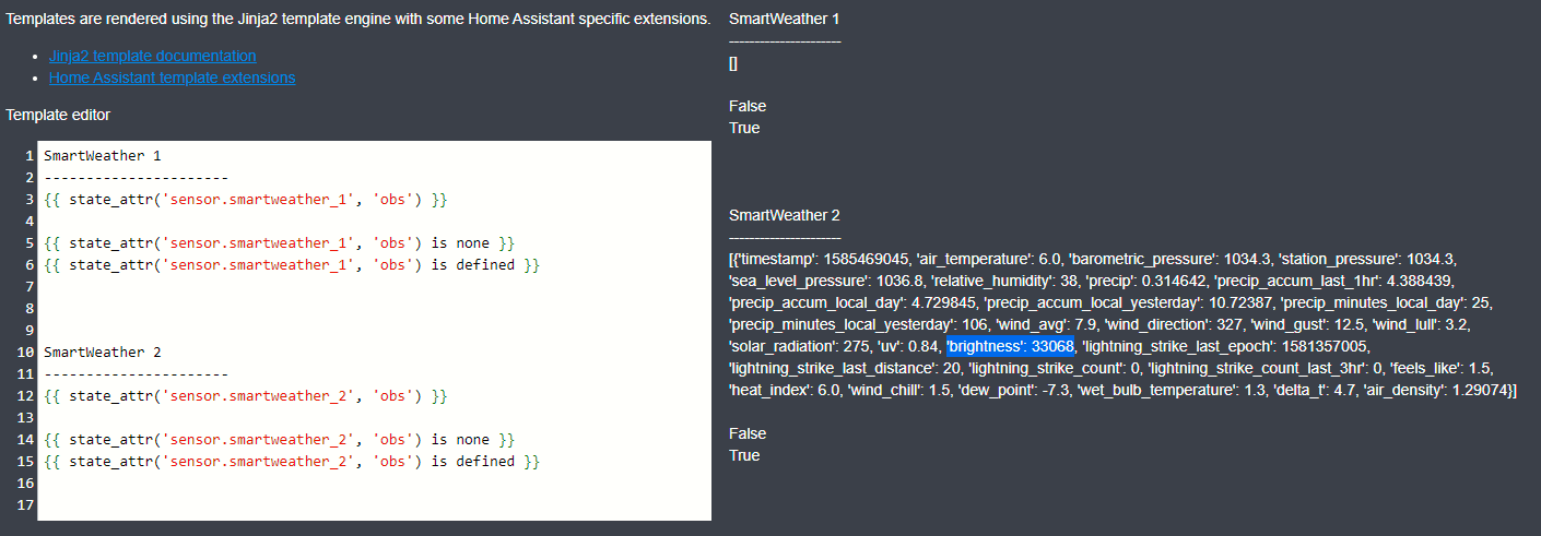

To be clear, what I am ultimately trying to do is create sensors templated on certain elements e.g. brightness (as highlighted)
Here is the Templates page showing two arrays, one populated and one not.
Thanks as always for any help/pointers.

{% set obs = state_attr('sensor.smartweather_1', 'obs') %}
{% if obs is not none and obs|length > 0 %}
  {{ objs[0].brightness }}
{% else %}
  unknown
EDIT: Or better yet:
{% if obs is sequence and obs|length > 0 and obs[0].brightness is defined %}
{% else %}
  unknown
Works well for whatever I throw at it. :+1:
