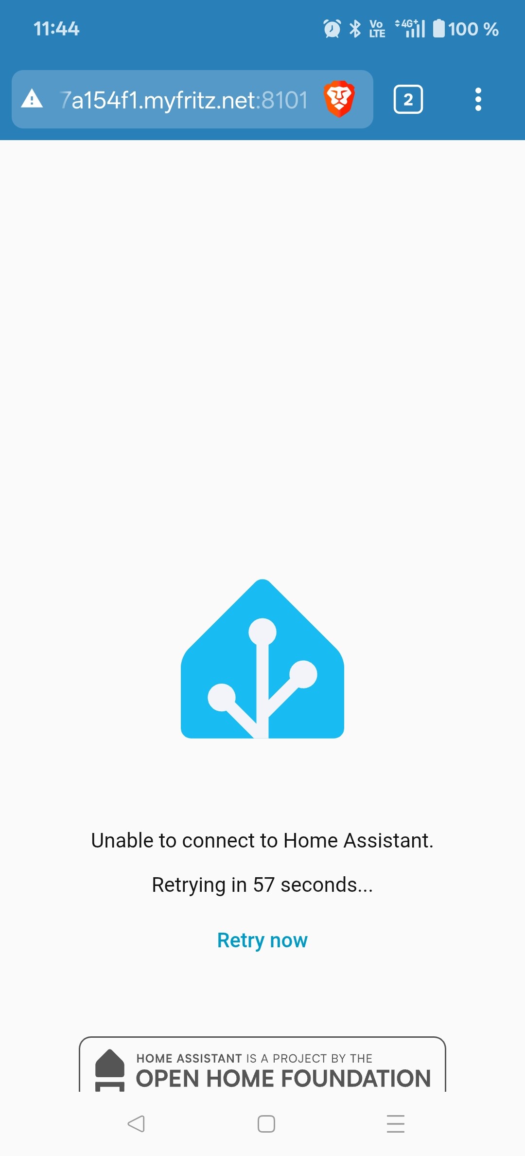

Since about 1-2 weeks I cannot access Home Assistant over my mobile/cellular carrier. It works locally and also when I am connected to a WiFi network at work or at a friends house.
I am using a DynDNS service to connect to the normal Webinterface of HA.
Over cellular network I only see this screen.

Do you see something in ip_bans.yaml ?
I figured it out, but just because I got lucky.
A few months ago I had problems with the cellular connection and found that the APN settings had a Proxy server in them. When deleting it these problems went away. So my carrier probably uses some kind of “trash” Proxy server :wink:
So today I checked again and they Proxy server reappeared in my Android APN settings. Just deleted it again and just like that I could connect to Home Assistant again. Probably some kind of phone update reset the APN settings and so I could not connect anymore.
Still don’t know WHY it did not work behind this Proxy. I also added it to my configuration.yaml as a test but it still did not work.
Anyway => Problem seems to be solved :slight_smile:
