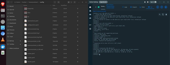

Hi, I have actually the same issue… I’d like to use HA within a container (moving on from using HA via Vbox VM) on my Ubuntu 22.04. It’s the first time I am using dockers, so everything is new to me.
This is where I am stuck; No UI right after fresh HA install (docker compose)
=> hence onboarding in HA ++…
My 2x containers seem to run well: Portainer is all good (with the port redirection) // I can also access HA:8123 when “only” forwarding port 8123 in the yaml file (but i’d like to activate the network mode: host).
On Docker Desktop: I can connect in the CLI in the container, so i tested few things:
  • locally, the container sees the port 8123 (127.0.0.1:8123)
  • but is unable to see the port 8123 on the host (192.168.18.17:8123)
  • traceroute from Container to Host is working fine
  • Files in the container config/ folder are well created when launching HA the first time (with values in it, so i am assuming there is no access-right issue (i read that somewhere…))
My checks:

container logs:
s6-rc: info: service s6rc-oneshot-runner: starting
s6-rc: info: service s6rc-oneshot-runner successfully started
s6-rc: info: service fix-attrs: starting
s6-rc: info: service fix-attrs successfully started
s6-rc: info: service legacy-cont-init: starting
s6-rc: info: service legacy-cont-init successfully started
services-up: info: copying legacy longrun home-assistant (no readiness notification)
Unable to find configuration. Creating default one in /config

FYI:
also, the container can access to the port 9000 of the host (portainer).
the HA logs are empty (in config/ folder)
finally, (if that can make a difference): I am running (perfectly) Ubuntu 22.04 on a macbook
Any hints you see that may help?

-v /home/allan/homeassistant:/config
Other issues could be multiple versions of docker installed, or docker not installed properly (see link below for correct install directions for Ubuntu), and not following the post install steps I posted above to make sure you can manage docker as a non-root user. You should be able to run all docker commands without needing sudo. If docker isn’t a root user, it usually can’t manage all the ports in host networking mode and properly bind them from container to host.
sorry, very old thread but in case it helps others => issue was related to user rights on the files/folders.
adding the following in the docker-compose file solved it:
    environment:
      - PUID=1000
      - PGID=1000
eventually, resetting the folders ownership “may have” helped too:
sudo chown -R $USER ~/<your_top_docker_folder>/
Same issue. Running the container image with exactly the compose file posted in the docs, it starts, portainer shows that it is running and happy, no web UI.
I am running other services, but even disabling the network host option and giving it the 8123 port doesn’t solve it. Can you run this without giving it full access to the devices IP?
