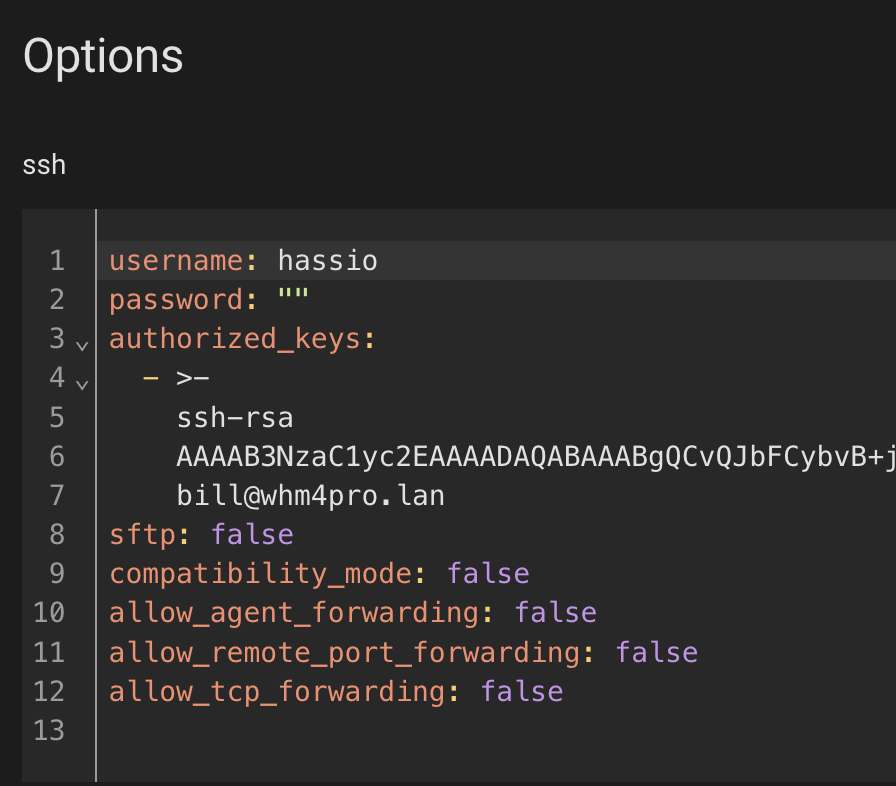

Yes, I initially tried to edit using the configuration editor.

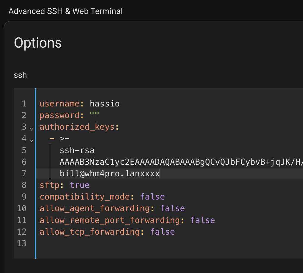

UPDATE: The below isn’t correct. HA writes the options.json when statting the add-on. It’s not the permanent store, apparently.
Note here I added “xxxx” after the key and changed sftp: true.
The add-on is currently NOT running.
I then hit “Save” at the bottom of the config screen, I then click on Info at the top of the page to move away from the config screen and then click back on Configuration and everything is reverted:
Weird.

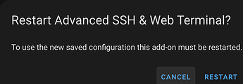

Now if the add-on is running and I do the same thing it will say I need to reload.
But, again, the config resets.
