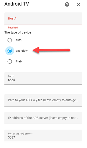

I see the same thing my side with the Firestick 4K Max.
Looks like this may have been ongoing for a while:
Android TV (Firestick 4K MAX) doesn’t display sources in media player except for current source / app. · Issue #66566 · home-assistant/core (github.com)
When adding this through the UI if you select AndriodTV that seems to fix the issue, don’t select auto or FireTV and that seems to work.
