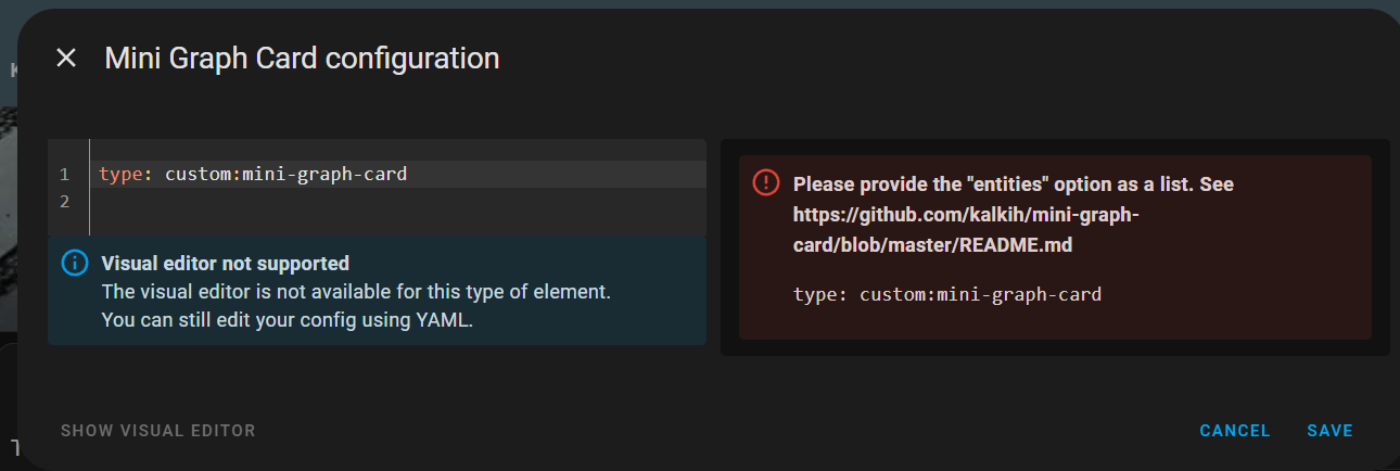

However, when I try and create a new mini graph, I get the following:
I’m stuck on if I still need an entry in configuration.yaml, and/or if I’ve put the .js file in the correct directory/folder…
Has anybody loaded this from scratch in a 2025 HA version and can point me in the right direction?
Many thanks from a noob in advance!
Not sure what this means.
This is not enough to define a graph - you need to specify the entities that you want in the graph. For example (from the docs):

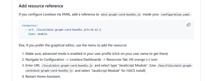

ok, thanks, I’ll take a look. I thought you just had to add something to the yaml as per below:
You do need to do 3 things:
  • download the javascript using HACS
  • tell HA where to load the javascript as a resource (your pic above)
  • Configure it in the dashboard (what entities to show, how should it look etc etc).
