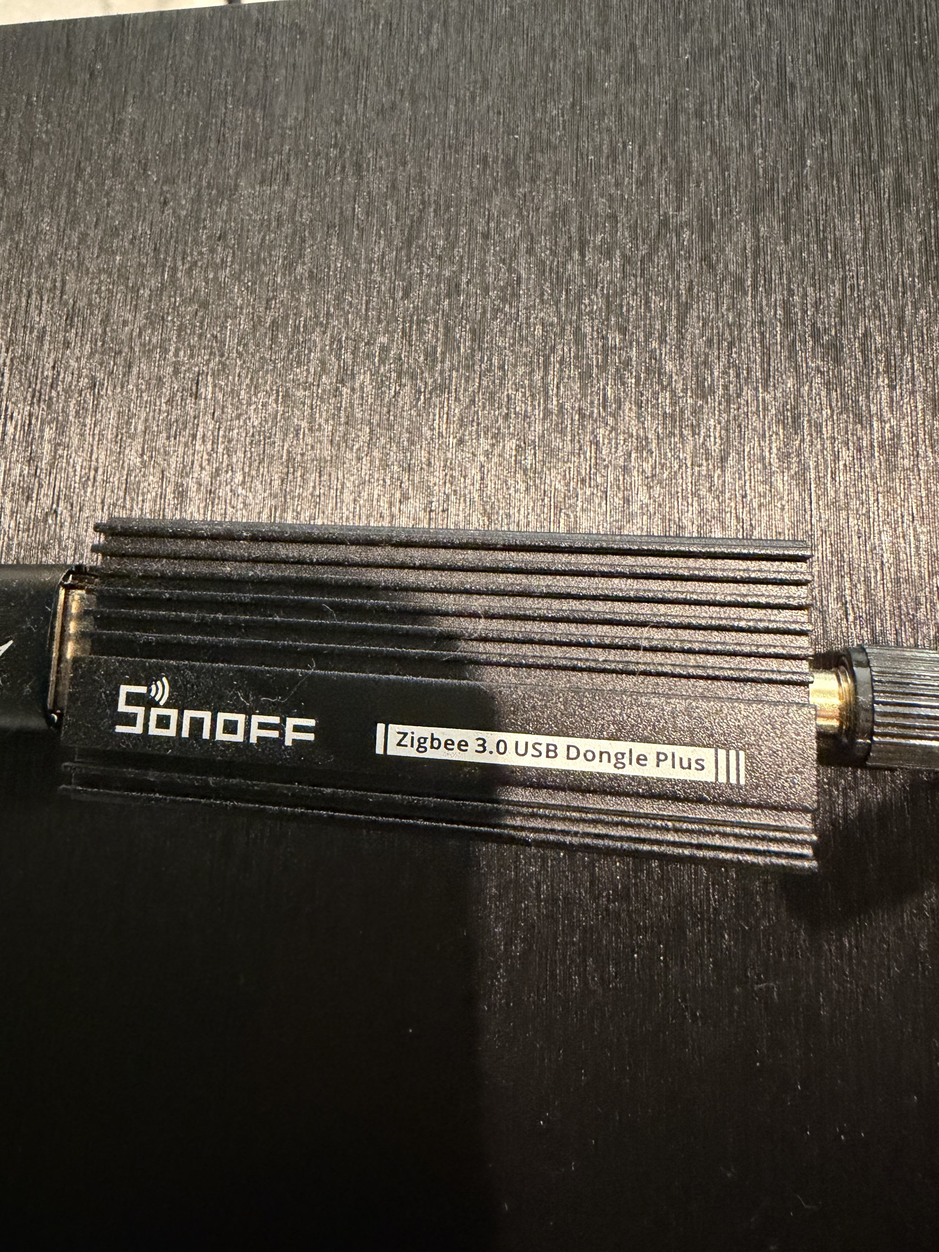

I have a sonof zigbee 3.0 stick. I have it connected to my Pi, and I am running HAOS in a VM (via KVM) in my pi.
ZHA shows up as an integration and when i go to configure it, it just spins at “Forming a new Zigbee network.” . In the HA host logs I see

That’s my device
