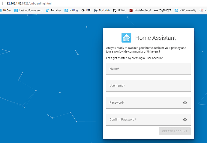

I just installed docker on windows for the 1st time ever(!) and ran this one:
docker run -d --name="homeassistant" -p 8123:8123 ghcr.io/home-assistant/home-assistant:2022.3
This runs fine for me…

So this is a screw up from my side, haha.
When @Tinkerer was saying host mode is not supported and to explicitly map ports, I just added the port mapping to docker-compose.yaml, without removing the network_mode: host line.
I removed it right now, in order to make it look as closer to your command as possible, and it works.
