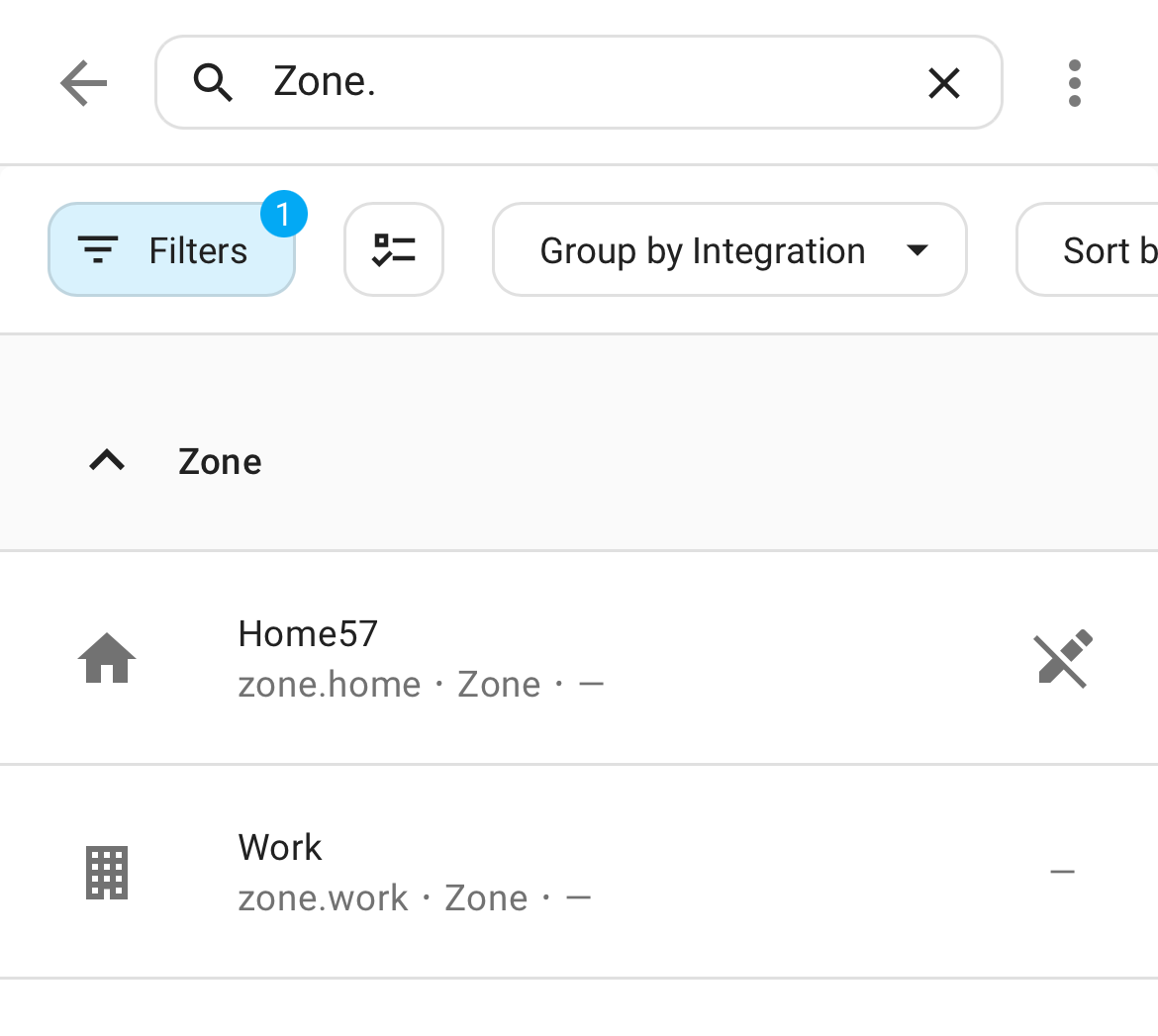

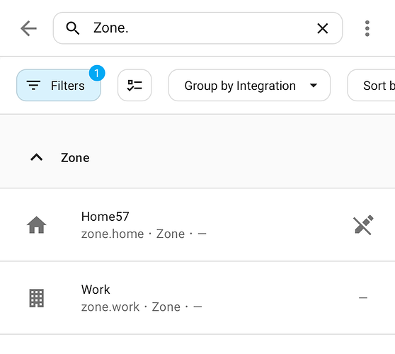

Well it’s mixed.
Via settings-zones, I can only edit the position and radius of the home zone, but I cannot edit the friendly name or icon (like the other zones)
Via settings-entities I can not customise as zone.home doesn’t have an unique ID
In the mean time I found out that the friendly name is automagically set by the system name.
Not a big deal, but just wondering why specially the home zone is limited like this
Suggestions to remove customisation in configuration.yaml is no option as I customised many entities via a separate customisation file: I extended for example every battery level sensor with the minimum level for that device.
I didn’t customise zones in that file

You’re right about not being able to edit the name or icon from the entities page. Then again, why would you?
I suspect it’s locked down to avoid deletion and renaming, given that other integrations like Sun use it heavily. At least the docs gave me this impression.

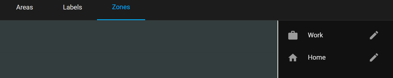

If you’re on HA 2024.8 or greater, then the Home zone location and radius is editable from Settings > Areas, labels & zones > Zones tab:
You cannot edit the icon or friendly name.

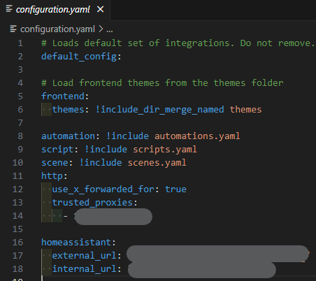

I am having the same problem, after first install i was able to edit the home zone under: “Settings>Areas, Labels & Zones > Zones”. Now I added some lines to the configuration.yaml in order to use it with nginx proxy manager. My HA Version is: 2025.4.2 OS 15.2. My configuration looks like this:
  1. Do not post pictures of code. Paste actual code, properly formatted
  2. Nothing in your screenshot resembles anything that would not let you edit the home zone if you’re on a recent HA version. If your version is somewhat recent, you should be getting warnings since external_url & internal_url were deprecated from yaml config 1-2 years ago.
  3. What is your actual issue with editing the home zone?
  1. Sorry for posting the code as an image, it was my first post here.
  2. The external_url & internal_url where mentioned in the topic for setting up Home Assistant alongside with NGINX Proxy Manager. But since you said they were deprecated i removed them from my configuration.yaml. Regarding the warning no i didn’t get one.
  3. My actual issue was that besides being at the correct page (Settings>Areas, Labels & Zones > Zones) i suddenly couldn’t change the location or range of the homezone. But since i removed those deprecated parameters the home zone is editable again for me.
So thank you for mentioning that those parameters where deprecated.
